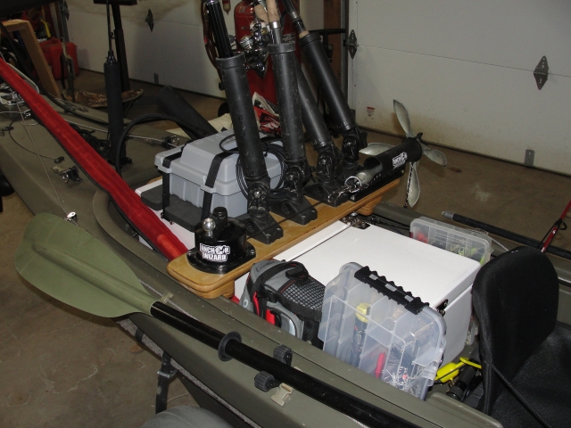

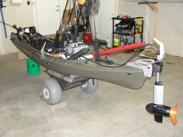

This view from starboard shows the Torqeedo motor and battery. I'm anticipating/hoping for 8 mph top speed with a fishing load. (Top speed was 8.7 mph with a basic boat.)

I built the 30-quart cooler using stitch and glue techniques. It's insulated with 1" pink styrofoam, is anchored to the floor via footman loops, and keeps fish cool all day. It weighs in at 19 pounds.
The assembly that holds the anchor and rods grabs the under side the coaming via a piece of 1/4" aluminum stock tightened to a threaded insert. This is a fast, secure means to hold it in place.
The Torqeedo battery is attached to the cooler via footman loops. It costs $900 to replace and I'm not taking any chances with losing it in a capsize.

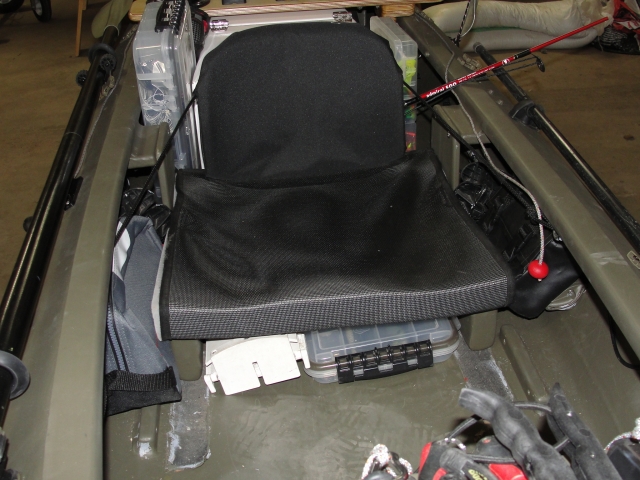

The Creature Comfort seat sits on a 1/4" plywood platform that raises it 4". I'm able to store my measuring board and a tackle tray underneath. This increase comfort a whole lot and doesn't significantly affect the Wood Duck's stability.
Notice also the removable hip braces which do a great job of stiffening up the 84" long cockpit. The raised seat is bolted to the hip braces via threaded inserts.

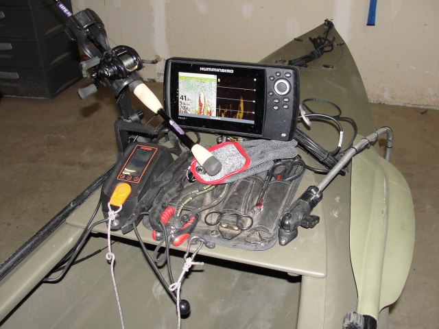

The fishing shelf is a game-changer. It holds everything in a convenient location. The fish finder transducer is attached via a Ram ball.
I sewed the hook removal kit and it comes in handy when dealing with toothy Northern pike. I'll design and sew one that fastens under the seat of my wife's sit-on-top kayak soon.
The Torqeedo throttle is just out of the way of my paddle stroke, but still a reasonable reach when under way.

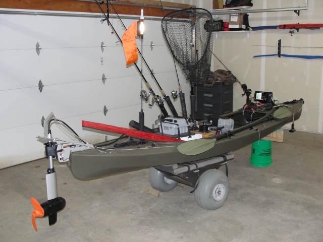

The anchor trolley runs the length of the port side and is a convenient way to change your orientation to the wind when anchored. I run my grapnel anchor through it. I also run my anchor pole through it when I'm fishing shallow water.
The Rule 1100 bilge pump evacuates through the fitting at the aft end of the coaming on the port side. The battery is stored in a custom box fitted to the aft bulkhead on the hatch side. The switch is fastened to the aft side of the starboard hip brace.
The cart rides on large, Wheeleze polyurethane low-pressure tires. These are amazing in sand, mud, and rocky terrain.
