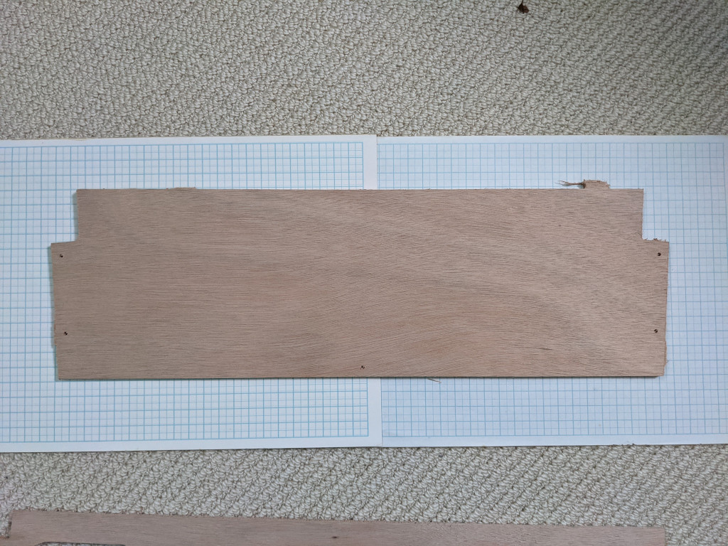

I'm building a Kaholo 12'6" from a kit. The kit I received contains a transom/tailblock that seems wrong to me. The instructions are clear that the longer edge of the trapezoid is the bottom, which makes sense - bulkheads 9 and 10 are also trapezoids with the longer edge at the bottom. And the instructions show the tailblock as a full trapezoid. The one I received has cutouts at the top, ostensibly for the sheer clamps, and is longer at the top than the bottom. I note that this tailblock resembles the one shown in the plans in the Nov/Dec 2012 issue of WoodenBoat, but it doesn't resemble the tailblock I see on most pictures of Kaholo builds.
Can anyone confirm that my tailblock is incorrect. In particular, can someone confirm that at the transom, the deck is narrower than the bottom of the SUP?
The cutouts seem wrong too - the sheer clamps are already terminated 1/4" before the end of the sides, so cutouts just leave a big hole.

Hello Patrick,
If you look at pages 5 and 6 of the manual, it shows the 12.5 transom notched and the 14 transom without notches.  Pages 14 and 15 show the same, so it appears that the one that you have is correct.  The picture on page 34 shows a transom without notches but the note says that is a 14 picture.
Why have notches on the 12.5 and not the 14?  Who knows, but it does appear to be intentional.
To add confusion to the discussion, I built the 12.5 Hybrid and the transom did NOT have notches.  Intentional or not, who knows?
In the end, it will not matter because you will be covering the plywood transom with strips on pages 48&49.  I used cloth instead of strips because that is what the customer (my bride) wanted on her board.

   Thanks Mark. Your board looks great. But can you confim for me the shape of your tailblock. Is it shorter at the top, or shorter at the bottom? It's really hard to tell from photos, since it's also steeply angled.
Despite the parts list and layout pictures, I'm not convinced my tailblock is correct. The notches will leave big holes in the build, and while they can be covered up, I'm not convinced the decorative cedar pieces (and you said you used material!) are supposed to be structural. The boat should be waterproof once the tailblock is on, surely.

No doubt it is possible that you got a wrong part.
The sides of the hull flair outward so the deck of the board is the widest part.  On my wife's board, the transom is ~17" wide at the deck and ~16" at the bottom.
If you are planning to use the "decorative" strips for the transom, the notches are irrelevant.  The decorative transom is 1/4" cedar strips with a layer of 4oz glass on top so it will be both water tight and plenty strong.  On my board, that is what the entire deck is made of.  Honestly, the ply transom is more of a frame than transom and could probably be omitted.

   Hello Patrick,
The longer edge is the top.  The shorter edge matches the width of the bottom panel at its aft end.
RE: Kaholo 12 Transom/Tailblock seems wrong
   Hi Jay - thanks for that. The instructions should be updated to clarify this, since they state exactly the opposite.
Do you have any comment on the notches?
