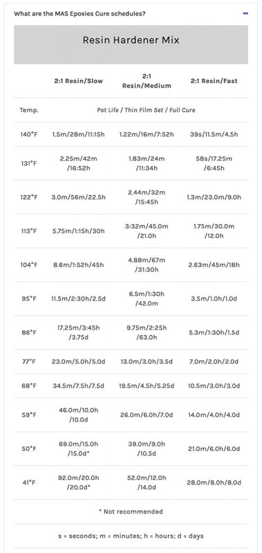

Somebody on this forum linked to the following table. Apparently, it used to be on the MAS website, and is not anymore, but I choose to trust it :)
I was misremembering about below freezing: the table only goes to 41ºF. But I definitely applied fast hardener at around 45-50º and left it cure overnight when it was around/below freezing, and it seems to have cured fine. (I am still building my boat, so who knows, maybe I put her on the water and she immediately falls apart... But so far so good.)
I must add that I always keep my epoxy and fillers at room temperature and bring them to the work space right before mixing. So even when it's pretty cold in the space, the epoxy itself is 65-70º, and I assume it helps to start the chemical reaction going.
