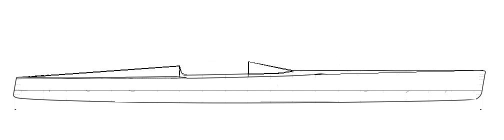

OK one more question. I like the looks of the longer bootlegger but only really need for one person. Can I buy the tandem and deck over part of the opening to make a one person? I was thinking of using the remainder with some hatches as storage
